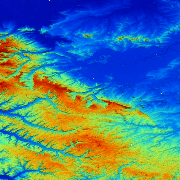

Importer un fichier SRTM 90
saga_cmd.exe "io_grid.dll" "6" -GRID "D:yvesMasterGestion_espacetemptest_import_cmd.dgm" -FILE "D:yvesMasterGestion_espaceFichiersN50E002.hgt" -RESOLUTION "1"
Fermer les trous du SRTM
saga_cmd.exe "grid_tools.dll" "7" -INPUT "D:yvesMasterGestion_espacetemptest_import_cmd.dgm" -RESULT "d:yvesMasterGestion_espacetemptest_close_gap.dgm"

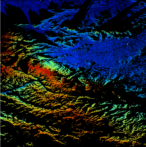

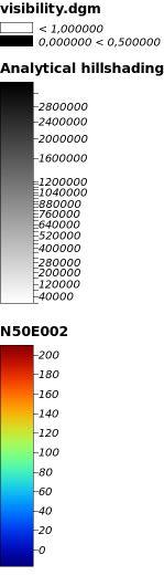

Calculer la visibilité
Module: Visibility (single point)
- execution interactive -
Menu: Terrain Analysis > Lighting
Vectoriser la couche de visibilité
Exporter la carte
Exporter un fichier
saga_cmd.exe "io_grid_image.dll" "0" -GRID "D:yvesMasterGestion_espacetemptest_import_cmd.dgm" -FILE "D:yvesMasterGestion_espacetemptest_import_cmd.png"
